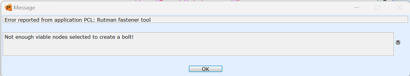

Dear all,
I am trying to model a Rutman Fastener in PATRAN (2018). I have a 3D (Tet10) bracket attaching to a spar skin 2D (CQUAD, PCOMP property). I have created a group with the nodes to join (3 nodes from the 3D bracket and 1 node from the skin, total of 4 nodes as shown below) not the whole model is shown for clarity:
The application to create the Rutman (and any relevant setting is shown below (units used are inches):
The Axis I use is the Z-axis of the coordinate system 99900003.3 (as shown below) and fastener location is top node 1 (as shown below):
GROUP "Fast_Nodes" (under Fastener Connections field) are 4 nodes shown above (Nodes 1-4)
When I hit "APPLY" to create the RUTMAN Fastener, I get the following ERROR:
Can anyone help me with this?
I have checked that all nodes are associated to elements, all elms have valid properties, increased tolerance to see if it makes any difference (although I have made sure that all my nodes (4 in this case) are all along the Fastener line (shown yellow in above pictures)).
Any tips are welcome.

I work at Hexagon. I do FEA but I don't have much experience with Patran. I asked someone knowledgeable who is pretty sure that Fastener Maker should work for this task; they suggest that the issue may be tolerances. They also mentioned that you need not just the corner nodes—but your drawing seems to show that corner and midside nodes are selected.
Update: It is now not obvious to us what the problem would be. We would need to look at the model. I would encourage you to contact Hexagon support.
