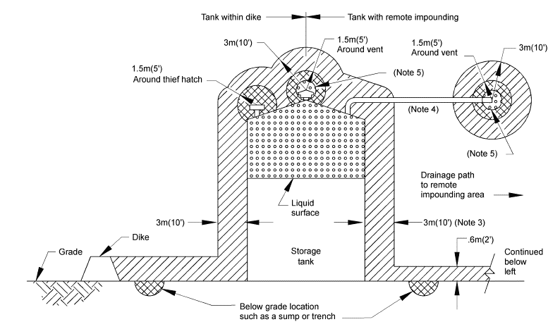

So, the question I am asking is this: does anyone have a general practice (GP) for the safe radius around an open manway under purge?
My own approach would be to treat this as a confined space area until my client can establish that the air is breathable. Keep in mind the pharma is usually a batch process. Key operating parameters are established during the maiden run of a product. That's what I am advising: take measurements around the manway and establish if the conditions are safe. If not, then add SCBA, an attendee, personal %O2 monitors, and %O2 monitors. If marginal, then add %O2 monitors, personal %O2 monitors and an attendee. Attendee? Companies will have one operator by himself if they can.

Only thing I can think of is to look at hazardous area classifications around vents etc. Zone 1.
Like this

LittleInch: I like the electrical area classification approach. I should have remembered that. I am an EAC expert. I will include the barrier limits based on API-500 or NFPA-497, if you wish. Thank you.
