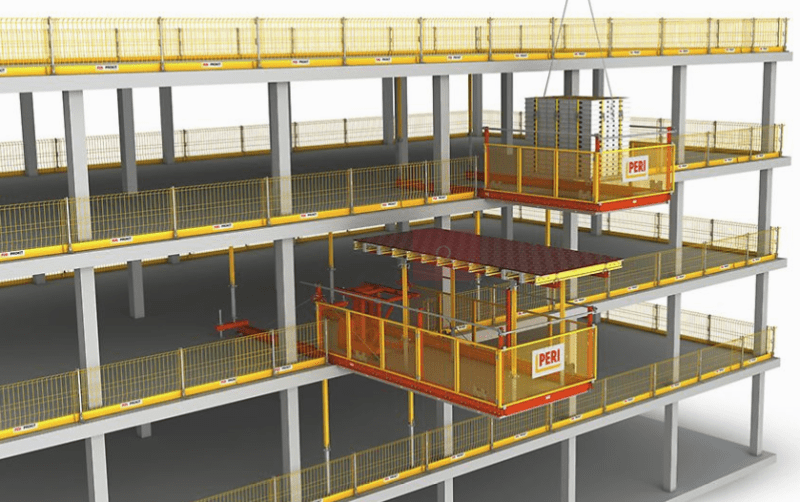

Hi, I am designing a temporary outrigger platform for a Multi - story building. I am wondering what is safety factor I should use for the platform floor and outrigger beam design? It is lightly loaded. S.F of 2 is good enough? Any codes and standards I should refer to? I don’t think outrigger platform should be designed for SF of 5 as outlined in ASME except lifting lugs. please advise.

It will be like "PERI RCS MP materiel platform" to move materials and formworks to high rise building.
If it's suspended by a crane and used to lift other stuff, it'd fall under ASME BTH, etc.
If it's supported off the building while the crane is detached, I'd say it falls under the scaffolding provisions of OSHA.
And if it performs both functions, it would need to comply with both.
And also needs to be coordinated with the building design if supported off the building.
I'd say JStephen is right on. The outrigger platform itself when locked into the structure is a form of scaffolding as outlined in OSHA 1926 and would be expected to maintain a 4:1 FOS against failure.
When rigged for flying, the anchor components engaged for lifting would be looked at under the ASME and likely be at 5:1. This can get into debate as it is the load being supported, and typically one would never permit the outrigger to carry load while attached to the crane. Our approach has been that the anchor points themselves are considered as part of the rigging and their attachment to the overall equipment would be at the higher FOS.

Use ASCE 37 to determine loading. Apply the ASCE 7-10 load combinations, pay special attention to D+L combos. If you're still uncomfortable, add an additional FOS for your own sake. I like to use the typical D+L combos plus an additional FOS of 2 when I'm using things like sand bags, water barrels, or deadmen to resist overturning; otherwise I stick to the ASCE combos.
Make sure your guardrail spacing and heights comply with OSHA.
As you can see in the PERI diagram, they like to install posts on their walers at the interior of the slab to resist overturning; if you plan on using this, make sure you check the slab appropriately or VERY CLEARLY state it is outside your scope on your drawings. Use the correct, factual concrete strength at the time of installation (if you install at 7-days, use 7-day strength, not 28). If you like to sleep well at night, follow through and make sure someone looks at the slab.
