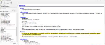

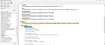

Hello, I have the following code:
ret = SapModel.File.NewSolidBlock(8, 8, 4,"" ,nombre_prop_solido, 4, 4, 2)
If I set the units to inches:
SapModel.SetPresentUnits(1)
Everything is normal and work as expected, but if I use anything but inches (meters)
SapModel.SetPresentUnits(6)
The dimensions of the solid block doesn't correspond with the values I expected.
What would SAP API work like this? I dont wanna hard code units
