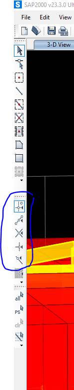

Hello,
I am relatively new to SAP2000. I used RISA before much more successfully, but I am still getting the hang of SAP's little details. How do I add a joint mid member?
I did a few searches but could not find a clear answer. Thanks ahead of time.

So, if you're just trying to add a joint somewhere along the length of a member, here are some suggestions:
3) There is a "snap" toolbar usually on the lower left side of the screen (see attached image) this allows you to snap to intersections, midpoints, lines, edges and such. Kinda like you'd do in AutoCAD.

Perfect. This is exactly what I needed. Really appreciate your help breaking it down for me! I knew there must be a simple solution to what I was trying to do. Thanks!
