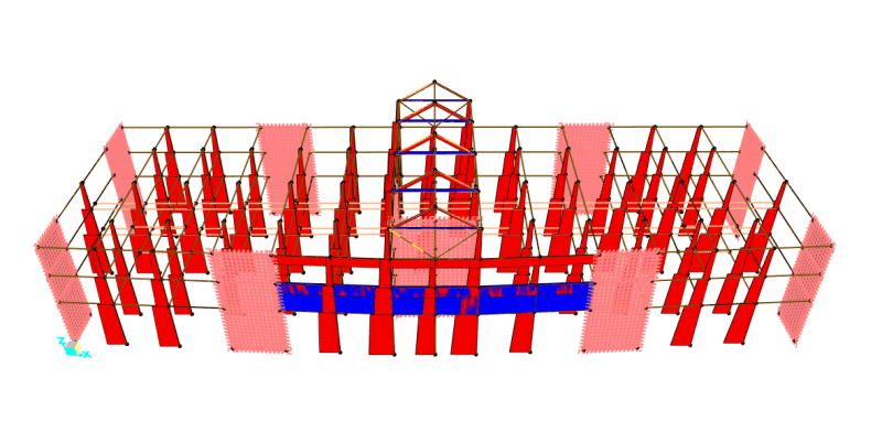

I am trying to model shear walls in my model. I am using shell elements, however when I add them in I am getting axial load in my beams, when my load case is only self weight. I do not know why this is happening. I tried putting diaphragm constraints in the Z-axis but this did not work. Also How am I suppose to handle the connection between the beams and the wall?​

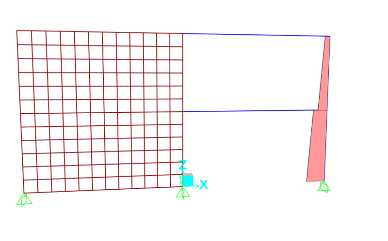

Well my frame is pinned at all connections. And when I model this type of frame in a smaller scope, I get 0 axial force. The shear was should be fixed at the supports, I forgot to do that but that shouldn't make a difference.

Under gravity load the self weight of the braces and beam over the braces will transfer to the framing below as horizontal and vertical loads. If all beam column joints are pins this horizontal load will traverse the framing in any means possible to reach the wall panels which are the only elements with lateral resistance.
Okay I have a follow up question because when I scale up my 2D Simplified Model I get come small (not nearly as large as my main model) axis forces in the beams. Why does this occur?

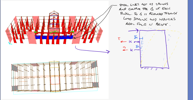

If you are running geometric non linear analysis, the columns shrink under axial loads. The shear walls likely don't shrink as much, and so the beams attached to wall shift a bit and pull the columns in to the shear walls, so the columns have a lean and now the structure has axial loads in the beams

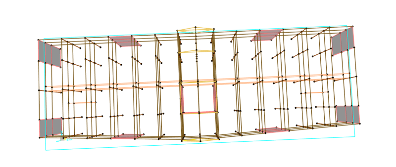

Okay so using diaphragm constraints in the Z-Axis on the shear walls along with a Area edge constraint so the shear walls have 0 resistance to out of plane forces. I was able to remove most of the axial forces in the beams. Besides the front middle. I do not know why it is experiencing so much axial load. I think it is due to the slight angle of the front of the building. Although I do not know why they are so large.
That bay is acting like a catenary cable between the two shear walls.
