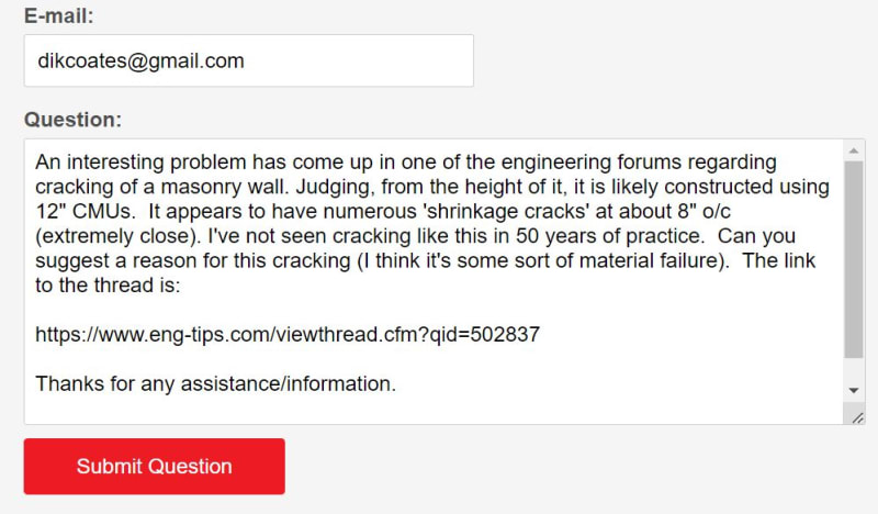

I've submitted the question to the Masonry Contractors Assoc of America to see if they can offer any suggestions.

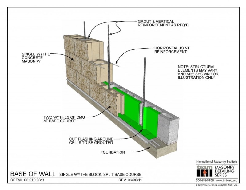

I looked to the International Masonry Institute web site and the following detail..
