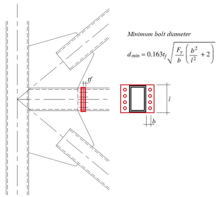

Hi dozer,
I suppose your biggest concern is about the transfer of forces between the gusset plate and the wall of the HSS column. I have attached a sketch of an alternative and more direct load path that requires a small modification in the work point. I would do the following:
1) Move the workpoint so that the vertical and horizontal components of each brace axial load are transferred directly to the column and beam walls respectively. That way, there is not bending and punching shear in the HSS column wall, only shear in the plane of the wall. This is, in fact, the Special Case 1 of the Uniform Force Method in the AISC Steel Construction Manual.
2) Account for any eccentricity in your analysis model.
3) If large transfer forces are expected, use a throw gusset plate to transfer the load directly to the beam.
Hope this help!

AISC 341 requires that gusseted beam-to-column connections be designed to accommodate demands corresponding to large drifts. This effect is also known as frame distortion or frame action. Two methods to accommodating demands corresponding to frame distortion are provided in AISC 341. In the first method, as described in Section F2.6b(a), the connection may be detailed to provide sufficient rotation capacity such that the beam and column are not constrained to rotate together as the frame deform. The required rotation capacity is 0.025 rad, which can easily be accomplish with a simple connection designed and detailed according to the AISC Steel Construction Manual.
The second method is described in Section F2.6.b(b). This method establishes an upper-bound demand based on flexural yielding of either the beam or the column. The connection is designed to resist a moment corresponding to the lesser of 1.1 times the expected beam flexural strength and 1.1 times the sum of the expected column flexural strength above and below the connection. This moment must be considered in conjunction with the brace forces corresponding to their expected strength. The connection may be designed to resist this moment in one of two ways. One of these ways is to analyze the entire assembly (reinforcing beam column) with the required moment following the procedure described in Section 4.2.6 of the AISC 29 Design Guide. The internal forces determined from this procedure must be combined with the internal forces resulting from each brace axial load.
I would go for the first method described above, that is, I would detail the connection to provide the required rotational capacity. A way to accomplish this requirement is to made a bolted splice in the beam away from the connection. This splice may be detailed as a shear end plate and designed considering the provisions of Part 9 of the AISC Manual to provide enough rotational ductility. Note that shear connections similar to those presented in the Part 10 of the Manual and meeting the rotational ductility checks described in Part 9 of the Manual can be assumed to provide a minimum of 0.03 rad. Attached is a sketch of the proposed detail.

Regarding you simple beam connection, this frame will be covered with plate welded directly to it, which, I know, throws a monkey wrench into the whole thing analytically anyway but that would be difficult to fit around that shear connection. Not to mention that would screw up it's rotational freedom.
