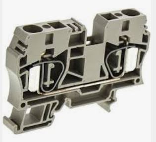

Here the rule was to go over all screw terminals one year after installation tightening them to required tightening torque while the machine just had been running being at working temperature.
For the reasons bacon4life has given.
The reason for this as I was told was that when you make the installation the machine is "cold" room temperature when you start running the machine everything gets warmer and the tightening torque isn't the same anymore, the screws can even screw themself out due to the changes from heat cold.
Off course doing this more than once you will eventually destroy the screw.
I saw that there were crimp bootlace used too, this can also create a problem if they are not applied with the right tool and force, the same thing will happen with them, they can also lose their shape if not applied right from changes in heat and cold making a gap between the crimp bootlace and the the wires.
One solution is using feed-through terminal with tension-clamp connection preferably without crimp bootlaces.
Like ZDU 10, Feed-through terminal, Tension-clamp connection, 10 mm², 1000 V, 57 A.
