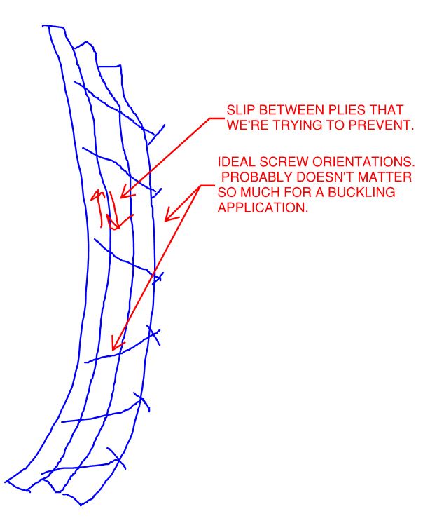

Hi There, just curious to know
In 18' tall wall 2x6, 2 king stud and one cripple stud as a built up column (3ply) fastened with sds screw staggered at 24"oc but screw get inclined as there was not enough space to drill, how much strength will reduce or should add one more screw in between to make spacing 12" oc
How much of an incline? Are you getting adequate penetration in the third ply?
1) For this kind of application, I believe that the primary purpose of the fasteners is to prevent relative, longitudinal slip between the plies. Given that, an inclined screw is probably better than one with no incline as an inclined screw would offer more stiffness to resist such slip.
2) As jayrod12 intimated, it's all for nothing if the screw doesn't actually penetrate all plies sufficiently.
3) The screws perform a load sharing function for transverse loads but I'd not expect that aspect of performance to be compromised by the inclined screws. With or without the incline, you've got some dowel action.
4) There would be a "right way" to orient inclined screws as shown below. That said, I've no doubt that this is not how it was done in the field and for an application that is primarily about buckling, I don't feel that it's terribly important.
5) If you're in doubt at all, go ahead and add some extra screws, perhaps reversing the incline.

Thank you so much All,
Jayrod12, it's is 5" long inserted at an angle of 30 degree, so for three ply 2x6, full depth insertion at 30 degree should be 4.5"/cos30=5.196

pdev, Is sheathing attached to studs to prevent weak axis buckling? Has the (1) 2x6 trimmer been designed to resist the entire vertical load? If so, little to no fastening is needed from a mechanics standpoint (although you still need them from a code compliance standpoint).
One might argue fasteners are needed to transfer lateral loads acting out of plane on your wall opening from your trimmer into your king studs, but one might counter this load can go from your trimmer into your sheathing into your king studs, avoiding the need to attach trimmer to kings.
Thank you Mike, yes sheathing attached form exterior and trimmer was designed for the vertical load
