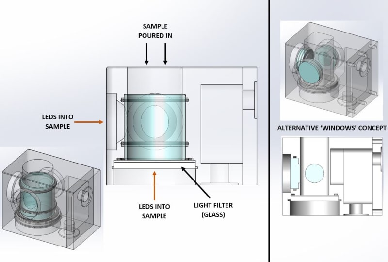

I'm designing a system where a sea water sample must have its temperature controlled between near its freezing point (-2°C) and +30°C to simulate sea temperatures. To control it, the sample will be in contact with a block, which will be controlled by an external circulating water bath. The image should be useful.
I’m new to the world of temperature control and heat exchange, so please correct me here.
MATERIAL SELECTION:
- I believe thermal conductivity to be the most influential factor, but have read up on heat capacity and a combination of the two – thermal resistivity. Are these other two worth considering here?
- Sea water, therefore, corrosive environment
- SELECTION: It seems aluminiums and coppers are typical used in water cooling system, but the sea water element leads me to the route of bronze, copper-nickel and titanium (based on wiki page, which I now can’t locate). Any experience of material selection?
DESIGN:
- I understand that it would be ideal to have as much of the sample in contact with the heat exchange block, but I must stick with a system using a glass tube as indicated.
- Air-cooled heat sinks have fins – do I want to go down a similar route of maximising surface area of block with water bath flow? I could add a number of drilled holes in that section.
- Should the volume of the water bath chamber be maximised?
- The block itself may be both smaller and larger in terms of volume of material. What pros/cons do they have? A large block would take longer to change temperature surely, meaning I want the block to be as small in volume.
- Worth going down the route of simulations?
Thank you in advance!
 https://files.engineering.com/getfile.aspx?folder=efbf8344-fd16-4168-9e0f-03bb79c524ae&file=Heat_Transfer_Question.JPG

Yes, external temperature-controlled bath flowing through the right-hand side. I've definitely simplified my diagram, but essentially I need a glass tube as shown, with the cooling coming from that water bath section on the right. Therefore, a Cu tube would not work.
What do you mean by 'shave serious flow limits'?
When you say Ti would be better, what properties specifically?
Still insufficient -- what is your time constraint, i.e., how long are you allowed to get the water to any given temperature? And why a water bath? That's an additional lag to get the water bath to the desired temperatures.
I'll try and upload a better diagram soon! It'll be in a lab environment where the test will be ongoing, therefore, time constraint isn't massively critical. I don't expect temperature to change in minutes, perhaps an hour or two would be at the user's limit! The tube shown is Ø25mm ID btw.

My apologies, my initial diagram was an early concept simplification - see attached for a better reason for having a glass tube. Essentially, all four bores are for optical purposes, with LEDs behind them. We had a previous product using the glass tube, but without the need for thermal control. Since this glass tube worked previously, we'd like to continue with this path. I've proposed an alternative, using windows - see image. There are optical issues with the windows concept (sample chamber is square in cross section), therefore, it is preferable to go with the glass tube.

Hopefully the attached image will help some of the reasoning for glass/block.
The plan is now to hold the sample within the water bath, meaning it is already at required temp, with the block used to maintain the preset temp.
Good point with the erosion - I expect it to see ~5 litres/min. Titanium would be difficult to machine, but we have the capability.

Hopefully the image helps this. The block will sit within an enclosure with humidity sensors so we will see the impact of condensation. And I concur with the glass preventing heat flow, but what suggestions can you provide with the current design to optimise? Or any other concepts that could work?
