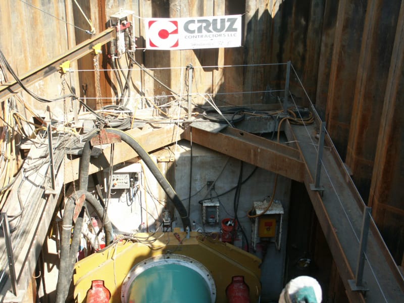

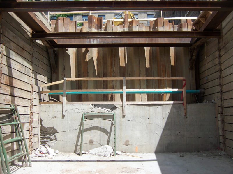

I have designed reaction backwalls for pipe and tunnel jacking forces up to 2,500,000 pounds. I usually design a reinforced concrete block to spread the load along a steel sheet pile backwall. The block is usually about the same width as the jacking pit and about 10 feet high. I design the sheet pile wall for passive resistance. With a safety factor on the jacking force, I calculate the required depth of backwall below the pit depth. I then calculate the bending moment and shear on the sheet pule backwall. I also recheck the backwall for a trapezoidal reaction pressure distribution on the backwall and then check the bending and shear. I design the backwall for the worse case bending and shear. These designs have worked fine. Whenever I needed a sheet pile size greater than what is available, I doubled up and used a double SSP backwall with the walls very closely driven (as close together as possible).
Jacking force was 714,000 pounds.
Jacking force was 2,500,000 pounds.
The cracks in the concrete block in the 2nd photo are from starting the demolition of the concrete block after the concrete pedestrian tunnel was jacked under the road.
