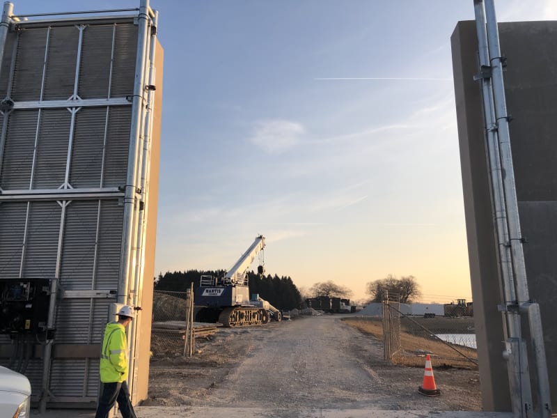

We just finished check out of the security gate at a large substation in cold climate. In addition to the various sensors and security features, the "apron" under the gate has embedded heat trace to melt the snow / ice.
