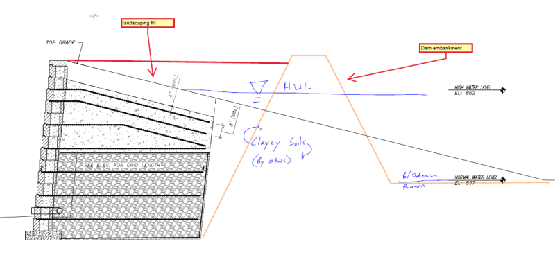

We are the specialty engineer for the segmental retaining wall and I'm wondering how to approach this situation. We have a wall that supports a detention pond. The top of the wall is at 863. The bottom of wall is 854. The HWL of the pond is 862 and the bottom is at 857. The pond is behind the wall. See attached sketch.
[ol 1]
[li]Would you design the wall to resist a full hydrostatic pressure?[/li]
[li]Would you apply hydrostatic pressure from 857 to 862 or from 854 to 862?[/li]
[li]Would you apply a buoyancy force to all the resisting soils below 862?[/li]
[li]Going a different route - would you use a free draining aggregate throughout the entire reinforced zone with a drain at the back of the reinforced zone to completely eliminate hydrostatic pressure?[/li]
[/ol]
Section here: LINK

I think I have set this situation up slightly incorrectly. There is a geotech involved and eventually we will coordinate. But for now I think the approach is that the berm behind the wall is constructed of Clay soils which prevents leakage (Not sure if there is a liner). The wall will be designed with free draining material so that any water can pass through the wall structure and prevent hydrostatic forces on the wall mass. The wall can be designed using saturated retained soils and dry granular weights. This is atleast a starting point. Then a more global study can be done by the geotech to see if that all works. Also they will need to evaluate/specify the clay layer and if any liner is needed.

whether this is regulated or not, it is a small dam
recommend that the wall be set back away from the dam embankment so it is not considered a part. the wall should be able to fail without affecting the dam.

cvg: I trust that outline of the supplemental dam is not to scale. Not wide enuff space here for the full dam, right? What side slopes? Not 1:1 or steeper I hope. Also for earth dam, with inevitable seepage, where is your toe drain? Gradations?

"oldest", sketch meant to be very rough but to illustrate a point. It does not include any details and certainly not to scale. Toe drains are not always required, the seepage analysis will provide the data to evaluate that. without knowing the geotechnical data, side slopes cannot be determined, but 1:1 is far too steep, this will be evaluated by the slope stability analysis.

To be honest there are a few negative comments on here which kind of surprises me for a detention pond which is normally dry. I suspect this is due to lack of information provided which I apologize for. Typically when I see a detention pond formed with berms there is 24" of clay liner. I would think if you provided a 24" clay liner or even less since this is a temporary condition that the detention pond would hold the water for a couple days. If the berm is made with relatively good stable play soils then the wall could be designed as "normal" with possible rapid drawdown And use of a free draining material in the reinforce does own would be appropriate.
Also, side slope is 4:1 currently.
I kind of see 2 different analysis's one which is more of a global perspective and follows the limit States which CVG mentions above. And the other is more internal and local to the retaining wall. I'm more concerned with the latter.
