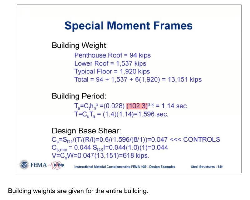

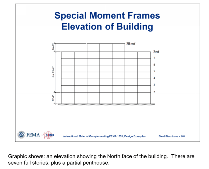

I don't believe you'll find anything more definitive in the code, but pictured below is an excerpt from the steel example in the FEMA P-1052 training and instructional materials. You may also have luck digging through some of the references for the approximate period equations used in ASCE 7.
Out of curiosity, have you modeled the building with the penthouse and compared the actual period to the approximate values?
Capped period is 0.868 seconds.
Actual period (without penthouse):
x = 2.04 seconds​
y = 1.83 seconds​
With the penthouse:
x = 2.20 seconds​
y = 1.94 seconds​
S&T
Makes sense. My understanding is that the code equations are empirical and capture real-world stiffness effects from cladding, partitions, gravity columns, etc. that are not typically included in a lateral system frame model. So you would expect your bare-frame model to have a longer period.
