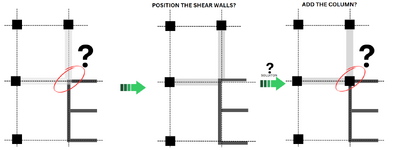

First, I have a doubt about how to solve these two details when connecting beams and shear walls:
"In the first detail, the beams are wider than the shear walls, so the beam will not fully rest on the wall. Should we match the widths of the beams and columns, for example, to 300 mm?
In the second detail, the beams are again only partly supported by the wall. Would it be better to reposition the wall so that both beams are fully supported, or to add a column at the junction?

I can only answer for Part 1
The general practice in my region is to have flush the beam with the column/wall.
In your case, if the column/wall is 300mm Width then the beam should be 300 as well otherwise it is aesthetically awful.
If flushing is not possible, I would add a beam that is perpendicular to the wide beam at the beam-column connection, in this case, it is aesthetically better.
For the second part, the easiest way is to relocate your outer column so that the beam can always flush with the core wall.
The reason is I don't think we can shift the shear wall as it may be part of the lift system so I wont shift anything to it, at least for my region。
If this is not the option, I will shift the shear wall as your second image.
I seen people putting the column as of your third image but it is not a preferred solution in my region, my clients always wanted to have a flush surface.
