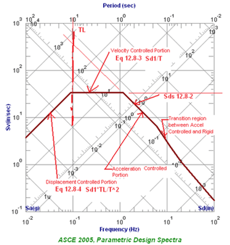

Hello all,
Does the seismic force distribution change between the North-South direction and the East-West direction? If I have the same seismic resisting force system for the both directions in my building. The building is rectangular moment resisting frame without irregularities.
Thanks,
