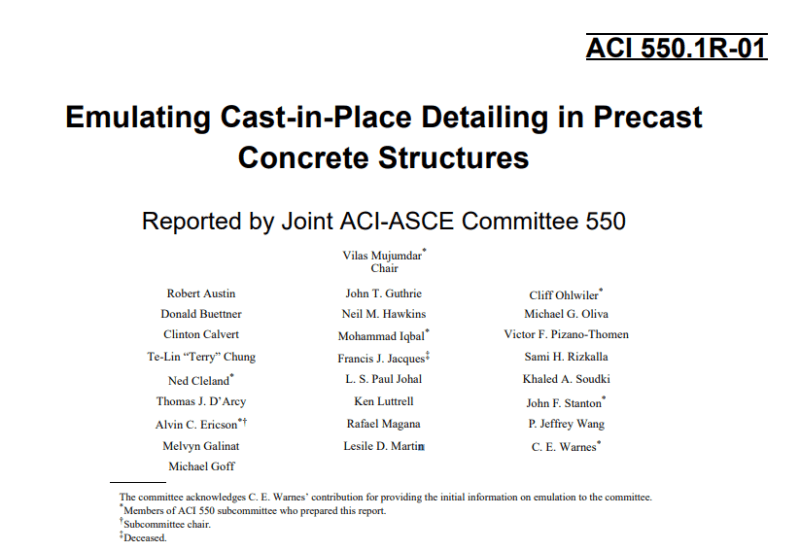

The monolithic character of CIP diaphragms certainly makes them much, much better at being competent diaphragms than precast decks in the absence of any specific design and detailing for diaphragm action. Personally, I'd go as far as to say that most CIP decks don't require much in the way of diaphragm design unless they are high aspect ratio, transfer level, or endowed with monstrous re-entrant corners, etc. Your typical high-rise condo slab usually does just fine with some drag bars at the shear walls.
In some regions, the situation is pushed even further and attempts are made to encourage precast detailing that emulates the redundancy and ductility of CIP systems.
Precast has many benefits but, as with most things, there's no free lunch. Precast is fast to erect because it's a kit of parts. And precast diaphragms tend to come apart when shook... because they are a kit of parts. A kit of parts that needs to be deliberately stitched back together by folks seeking to minimize the cost of that effort.
