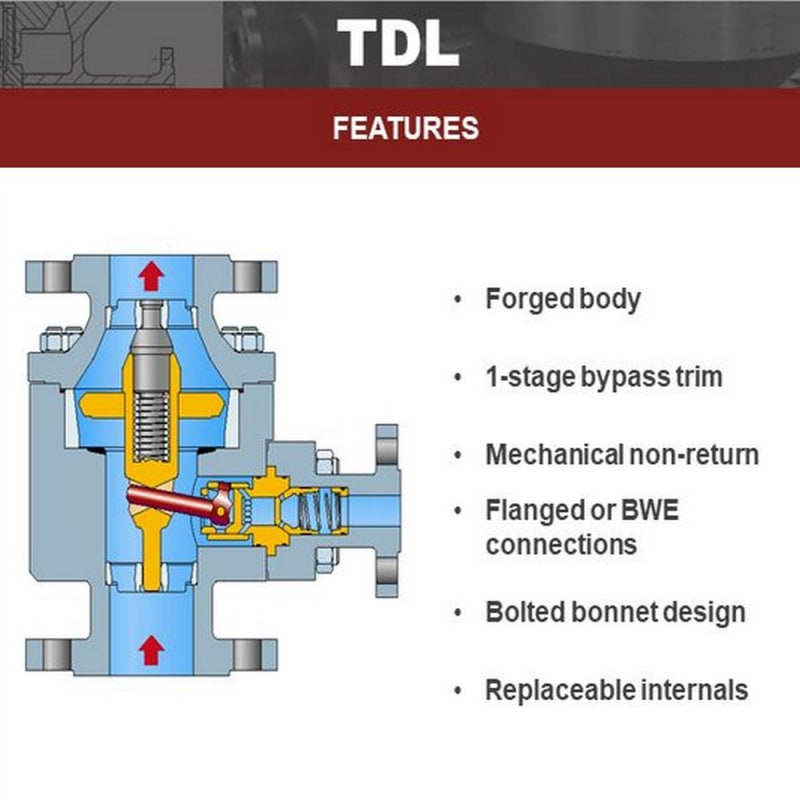

Okay, I see the ARC on these pumps. Q-h curve is fairly steep at around min flow, so ARC should work in principle. Presume the ARC is set to recycle some 25m3/hr (ie some 25-30% of 75m3/hr)- I dont see the performance datasheet for this ARC which shows flow and dp at which it recycles min flow of approx 25m3/hr.
On pump B, have you tried running this pump completely on recycle (ie with discharge valve fully closed, suction valve fully open) for some 5minutes at least. Any sign of overheating in pump casing ? Pity there is no TG or TT to tell.
georgeverghese

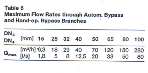

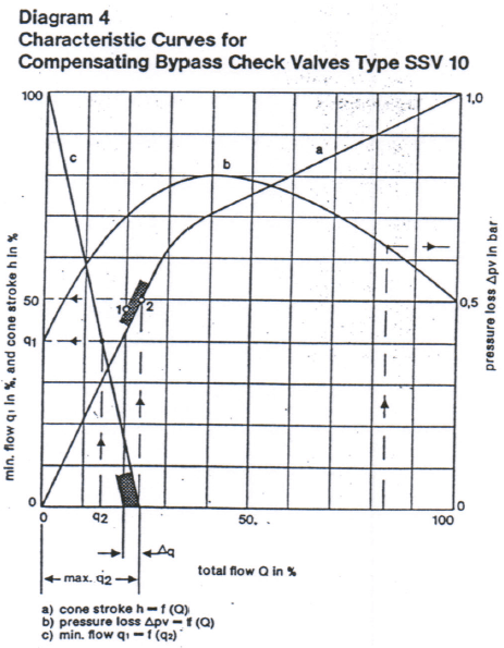

Regarding the ARC datasheet, I'm not sure if this is what you are looking for, but there is a characteristic curve for this valve on page 2 of the 4th link from my previous reply. If this is not it, unfortunately I couldn't find it:
The branch is designated DN3 which is 25mm in diameter and based on Table 6 found on page 3, the maximum flow rate for that branch is 18m3/h which is pretty much about 25% of 75m3/h as you mentioned (75*0.25 = 18.75)
We have tried operating pump B completely on recycle for at least 5 minutes. No apparent issues were observed but it is pretty subjective. But yeah, no temperature indicators to tell if it is overheating or not.
I was looking for the datasheet specific to this application. 18m3/hr may be the max, but what is the actual flow through DN3 when mainline flow is zero? Is this table 6 based on water ? Pump min flow also not stated on Uhde pump performance datasheet - sloppy of this contractor. This info may be in the original Sulzer datasheet. Looks like Uhde did not fill in a great deal of info on their company datasheet as part of vendor data incorporation.
