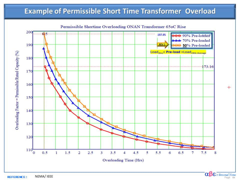

See IEEE 57.96 Table 5—Daily loads above rating to give normal life expectancy in 30°C average ambient for transformers with a 30 min time constant
3.4 Loading on the basis of short-time loads.
Below is an example of permissible short time transformer overload for various pre-loading scenarios.
Hope this helps.
I suggest that the total cycle time and the RMS loading should fall below the curves that Cuky2000 just posted.

Cuky2000, thank you for the graph. Can you please explain the difference between the orange and red graph - they are both 90% pre-loaded?

There is a typo error. The orange graph is for 50% preloaded condition.
Please notice that as higher is the preloading on the transformer, lower is the allowable overload. At 50% pre-loading, the transformer should be capable to virtually double the self-colling kVA capacity. That makes sense since the thermal energy capacity of oil/winding/core assembly will have more capacity to absorb heat during the overload scenario if preloading is smaller (less pre-heat).

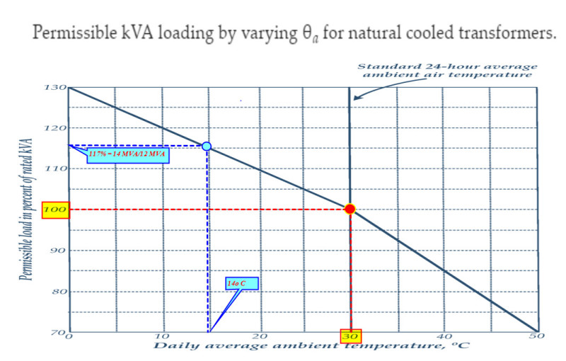

Transformer rating is based in a daily average standard temperature of 30oC. The enclosed Link provides a correction curve for ONAN/ONAF transformers for a different daily average temperature.

Below is a revised curve correcting the orange value.

Those curves were developed for a small distribution transformer per IEEE Std C57.92 as originally posted (75 kVA?). I believe that is also applicable to medium-sized power transformers following the notes of cautions as state below. It should be noted that this approach was followed by several larger US utility in the US for many years with fairly good degree of success and still some of them are used in their loading of power transformers.
Mos recently and extended to larger power transformers, base in IEEE Std C57.91 or IEC Std 354, It is a common operational practice to address normal life expectancy, Long-time emergency, and even Short-time emergency loading.
Utilities in the US often use the EPRI PTLoad v.6.2. software to predict the allowable load under a particular overloading scenario. Occasionally, the hard decision is made to scarify some loss of life went there are no other choices.
NOTE OF CAUTION: Engineering judgment is suggested to be on the conservative side with a reasonable safety margin for overloading the transformer beyond the nameplate since there is a danger of the winding temperature exceeding the critical temperature. The following is recommended:
