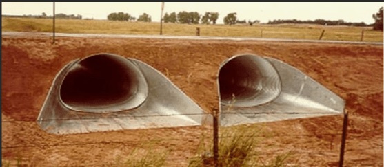

Maybe this culvert supplier can help!?
The original picture did not account for arching in that sense from what I can see. As PEinc indicates, likely just large steel soldier piles in deep concrete plugs. Quite common actually. It does not take into account any arching strength, but may consider some soil arching on both the retained side above the cut, and the resisting side below the dredge line.
