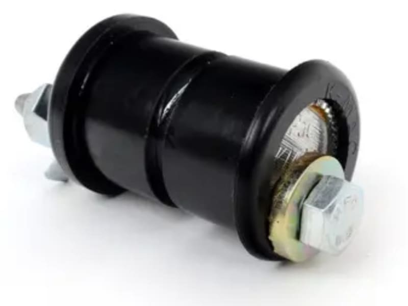

Thanks. The standard E30 arms are 15° and race cars had 10° to 12°. On the 2002 suspension, I'm mindful of the bum down nose up attitude of the 2002. Mine has that as it is as the ride height set up by a specialist race car suspension bloke. The main problem I have been getting occasional sudden oversteer. I think it's binding of the flimsy 2002 rear STAs with Kmac toe/camber adjusters which have a large metal eccentric bush with little compliance. E30 rear suspension offers stronger diff and arms, disc and a stronger diff.
Lateral cornering loads cause toe-out compliance-steer of all trailing-arm-type suspensions - whether it's bending of the arm itself, or compliance of the bushings, or bending of the subframe that the arms are attached to.
