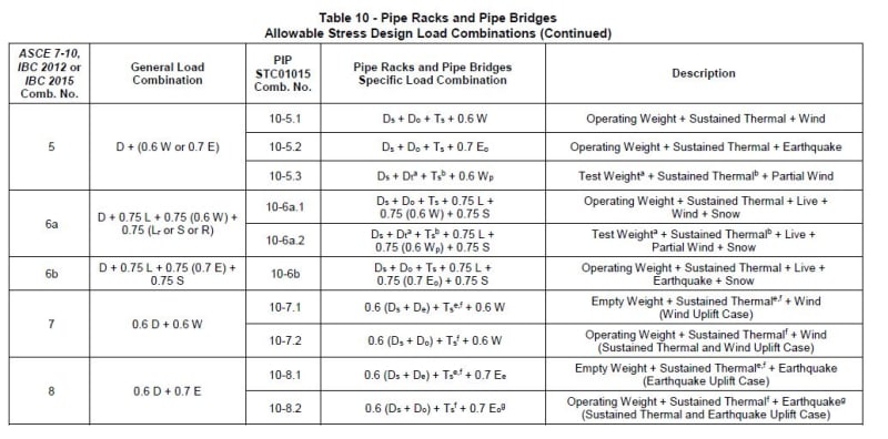

I'm having an issue trying to understand why this difference exists between ASCE Guidelines for Seismic Design on Petrochemical Facilities and PIP STC01015.
On ASCE, recommended load comb is:
0.9Ds + 0.9Do + Af + To + 0.7Eo (Table 5.1, comb 4)
On PIP (2007), it says:
0.9Ds + 0.6Do + Af + To + 0.7Eo (Table 7, comb 4a)
I cant' find the reason for using 0.6 or 0.9. On PIP, there's a note saying "0.6Do is used as an approximation of De", but it's a combination for the operating weigth, not empty one.
Anybody has any information on this?
