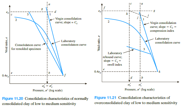

For your Cc determination, Schertman 1953 says to run the test to 0.4eo and adjust the preconsolidation pressure void ratio up to the NC eo or estimate the OC adjusted eo by following Cr from insitu sigma to preconsolidation sigma. Likely your lab equipment wont be able to get to 0.4eo but you can still run the trend out to that point and construct the adjusted Cc for disturbance. See below photo from Das. Was this considered?

I used the strain energy method to determine the preconsolidation pressures. And yes, I plotted the field consolidation curves to get Cc, but my stresses from foundation loads plus insitu will fall below the pre-consolidation pressure.
