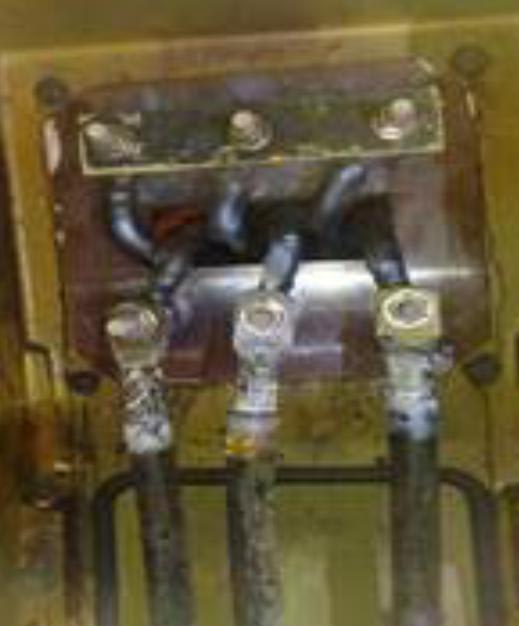

Cables/lugs burnt in motor connection box

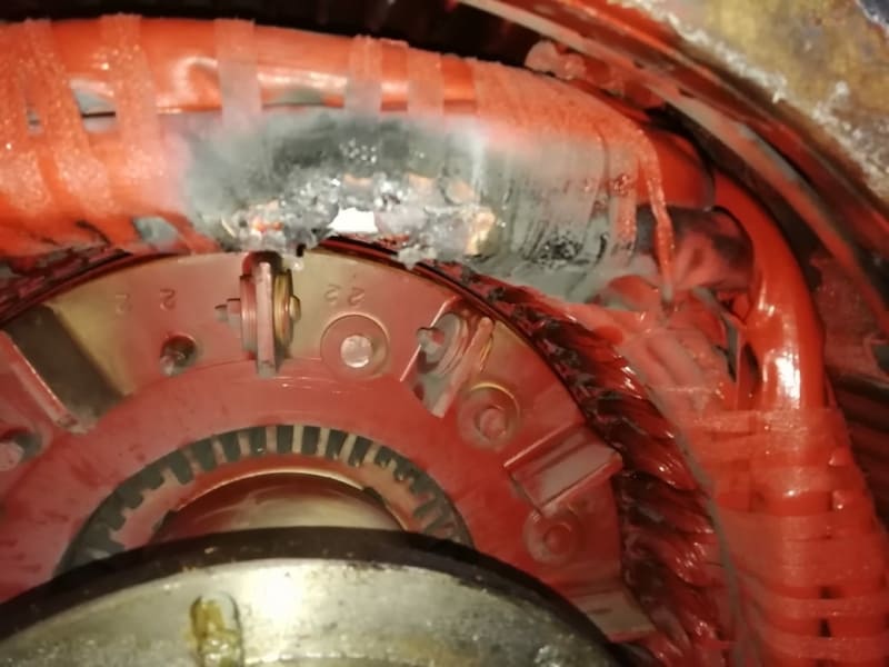

Latest motor winding damaged
 https://files.engineering.com/getfile.aspx?folder=7ae6b0dd-75aa-4b0c-9cf9-66e487257369&file=Cooling_tower_motor_burnt_connection_box.docx
Here folks are the 2 pictures.
and

It appears that the failure of the winding may be where the lead connects to the winding.
The heat generated by a loose connection will conduct down the lead wire.
I have seen other cases of secondary damage caused by the heat from a poor connection being conducted by a copper cable.
It looks as if the connections were not tight enough.
Possibly the connection was not properly cleaned before assembly.
Possibly both.

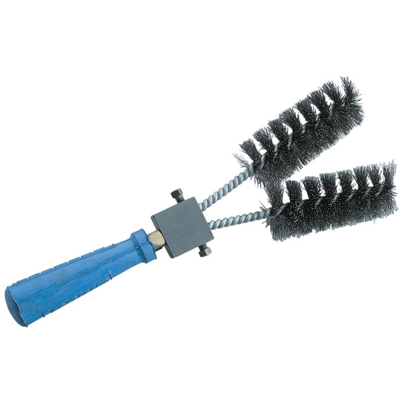

Burnishing stranded cables prior to connecting.
This brush from Erico, the Cadweld people does a good job.
I have bent the brushes to be more parallel. (Can something be "more parallel"? You know what I mean)

I think Bill's suggestion is plausible. There's no doubt heat conducts very well through copper. The location of the failure is in the endwindings on the connection end circuit ring which could very well be connected directly to the T-leads.
Imo it's also worth considering another scenario: degradation of a winder-made connection in the endwinding at the location of the failure that has degraded (you could probably tell by closer inspection of the fault area whether or not that is the location of a connection).
Is it likely to have two different unrelated problems (loose field terminations and degradation of winder made connections)? In general that's not likely... but not impossible.
The insulation on those leads entering the motor looks a little thermally damaged but not all that bad. I don't see evidence of heating on either side of that winding fault in the endwinding which might be expected if heating conducted by copper from remote high-resistance connection was carried along this entire path. These factors push my thinking towards the winder-made connection fault, but by no means conclusive. Again a closer inspection of that failure area could show if it is the location of a winder-made connection and therefore give an idea whether my scenario is even plausible. While you're at it, map out at the discoloration patterns of the T-lead and the circuit ring to get an idea of which areas have seen overheating.

Thanks for the support Pete.
Take a look at the heating patern on the winding end.
Does it seem to be spreading in the direction of the T lead, but not so much in the other direction?

I see what are probably balancing weights attached to the fins of the rotor with a screw and nut. This does not seem very secure. Are there any missing weights that may have come loose and damaged the winding (indicated by an empty hole in one of the fins)? I think I see such a hole in the lowest right fin.
The winding damage does not show indications of slow overheating but rather a momentary arc.
Clearly there is some gray ash that has spread out over the surfaces (under the wraps) after the fault. I see that grey as a surface condition, not an indication of overheating the depth of the insulation (for that I'd expect texture change creating non-smooth surface in addition to color change). I'm admittedly reading a lot into a fuzzy picture.
Another way to think about it is the temperature profile of the conductor. Assuming that loose connection in the t-lead terminations is the source of the heat, then the highest conductor temperature is at that location and the conductor temperature trails lower as we move away from that location. On that basis we expect more damage at the location of the t-lead terminations. Sure the circuit jumpers are more tightly-bundled which provides thermal insulation... but that area cannot end up hotter than the t-lead terminations or else the heat would be flowing the opposite direction (from circuit jumper to T-lead terminations). Maybe the insulation used in the endwindings has lower thermal rating than the t-leads... it would not be typical but it's possible.
For me personally, I would lean toward initiation at the winding connection, but it's a coin flip without more info.

The last breakdown ie flash on the winding is not representative of the previous problems on the 4 motors. The usual problem is lugs, motor leads and supply cables heated up inside the connection box. When we stopped for annual maintenance or a planned stop, we noticed this heating up inside the connection box.
This is often caused by poor workmanship. Surfaces not well cleaned, connections not tight enough.

The failure shown seems to be a workmanship issue. The transition from the random winding multiple copper conductors to motor take-off leads with even thinner wires is a tricky job that requires certain winder skill set.
Muthu
The rewinder came and inspect the motor just burnt. He said there is water inside the motor. He also said that the 95 mm2 that he purchased locally might be of poor quality. He is willing to repair the motor free of charge.
