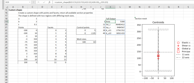

The shear area in 3 direction of an I section is different in SAP2000 and ETABS as shown in the image. Can someone please explain me how the shear area is calculated in SAP2000 and ETABS? I read the manuals but I couldn't find any difference. Thanks in advance

I have not used SAP2000 or ETABS, but I have checked the section properties for the given shape (with no corner fillets, as defined) using Strand7 and Robbie van Leeuwen’s SectionProperties program (with my Excel front end) and I find that:
- All 4 programs agree exactly on the Area, Ixx and Iyy
- Strand7 and SectionProperties agree within 0.2% on the shear areas, with A_s11 = 2750.5 mm2 and A_s22 = 1810.4 mm2, which are significantly less than the SAP2000 or ETABS results.
SectionProperties input and output:
Doug Jenkins
Interactive Design Services
The 29.167 cm2 answer is 5/6 times the total flange area, being the number for a rectangle. Can't help with the other, maybe something to do with shear strength instead of stiffness?
19.2 is the web area, but both that and the 5/6 flange area are rough approximations, whereas the SectionProperties and Strand7 values are based on an FEA of the actual cross section shape.
Doug Jenkins
Yeah, I meant the 33.129 number. But shear area is kind of academic mostly: either small so approximations are fine, or the member is short so you need to consider other factors.
