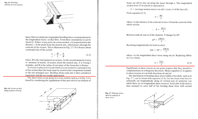

Here's the physical meaning/derivation of VQ/I, which is written as S*(A*z)/I in the last equation. I find this useful to understand what you're actually calculating. Basically, the varying bending moment causes the axial stresses to vary along the length of the beam. When you integrate them at two sections, you get two different axial forces, with the shear flow being the force required for axial equilibrium divided by the length between the two sections.
Another way of thinking about it is the weld needs to transfer more force into the reinforcement element when the bending moment increases. In your case, part of the reinforcement is in tension and part is in compression, which is why you subtract part of the area when calculating Q, as the net tension force is reduced by the compression component.
This way of thinking can help when you're not in an elastic situation, as VQ/I is only valid for linear-elastic stress distributions. You go beyond this when the section starts yielding, or in cracked composite concrete sections.
Great picture, dik, but the shear stress is not zero at the neutral axis - it is typically maximal at that point.
The picture describes it as being the area from where shear flow is being calculated and where the shear stress is zero, which is the extreme fiber. The picture appears to be correct.
The shear stress is calculated at the distance y. The top steel beam would be the A' value and the distance from the composite centre to the centroid of the top steel beam would be the ybar value. It gives the connection shear at the intersection of the W and the T.
I stand corrected. The wording is weird, though. I would not describe the first moment of area as done in that picture.
