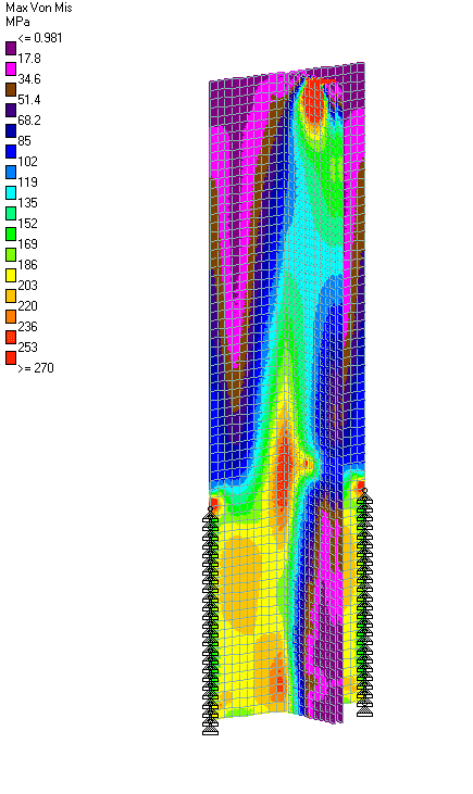

The situation I have is that back to back angles are welded longitudinally only to a plate, but not with the typical orientation of an angle on each side of the plate, but both angles on the same side. If this were a WT, the approach would be simple, but how do I connect these so that they are composite like a T, or how do I account for the shear lag otherwise?

@271 - that's the plan. I'm actually going bolt them together with a spacer, have some quick FEA to justify it. Would like the warm and fuzzy feeling of it codified somewhere though.
