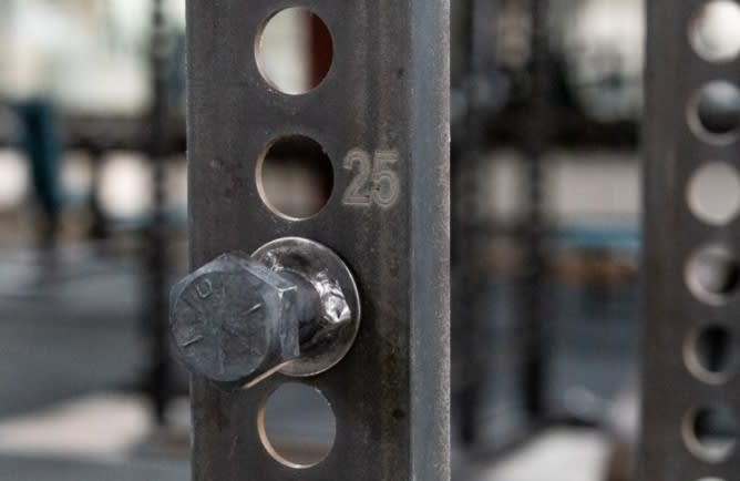

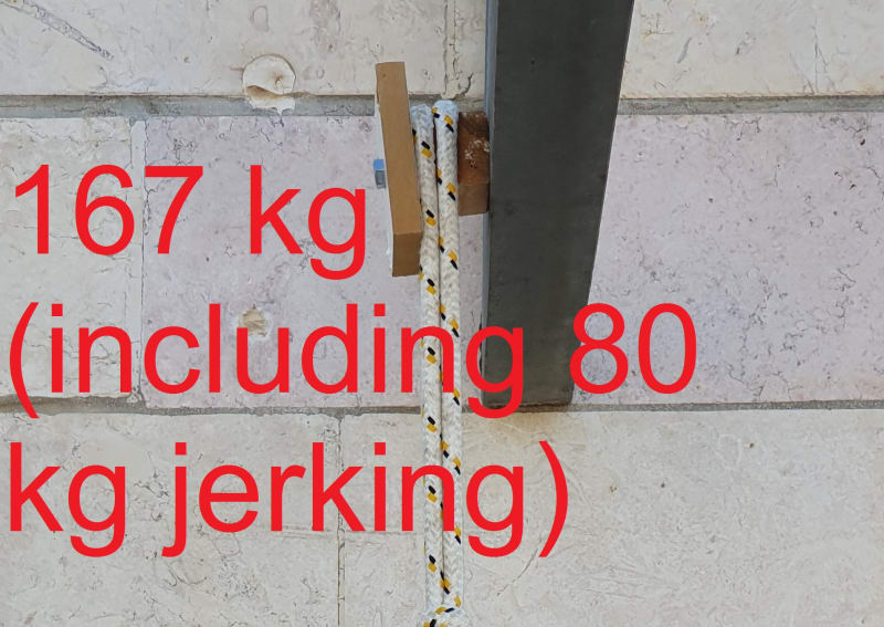

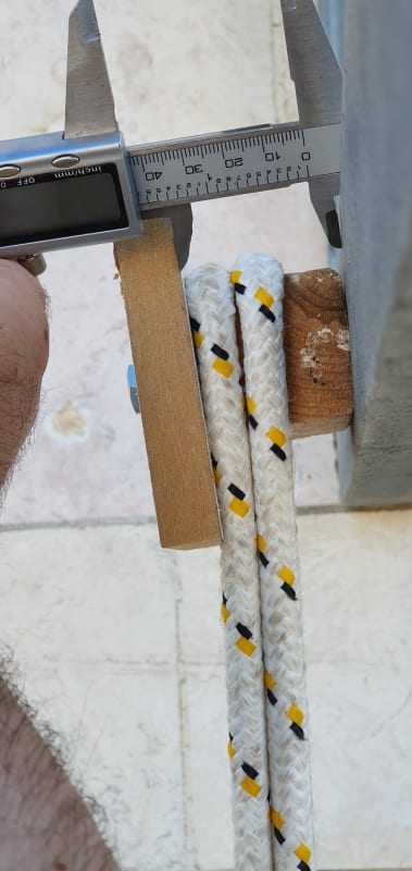

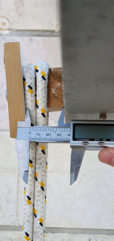

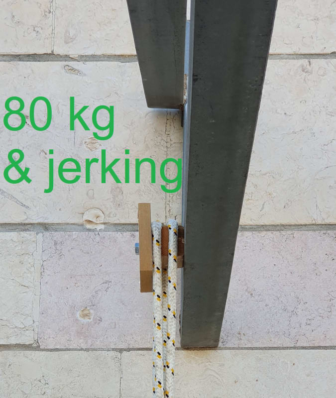

Hi all.
Trying to build my DIY weightlifting rack (bench press & squatting).
The two beams are 60x60 mm (3mm thick) galvanized steel.
The issue is with the hinges. Making a special welded hinge is too expensive.
Thought of using M22 bolts. The Olymic barbell will rest on one M22 bolt on each side, must hold up to 150 kg on each bolt (~300 lbs), about 5 cm from the beam.
Will it hold?
In the image (model): pencil = barbell
Did a test with an 11 mm thick bolt, bended after just 50 kg, and completely at 75 kg (although I placed the load ~9cm from the securing nut).
