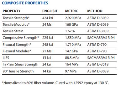

I only have the table below from Toray website.
What is the specific Toray material? Fiber and resin? Tape or fabric? The above values are for a tape.
@SWComposites, thanks for the link. I did come across the spec you shared. Based on the spec, I suspect T800H is for fabric as the properties seems like fabric properties.
If it is a fabric, why don't you model a unit cell of the fabric using the properties of the individual fibers and matrix using micromechanics? That way you can load the unit cell to find the tensile properties, the poisson's ratio and the shear in the plane of the fabric. It has worked well for me.
