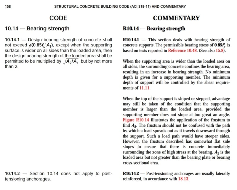

This is a typical plain concrete bearing resistance problem. It is covered in section 10.14 of the ACI 318-11 Code.
Cheers..!!
Code:
This? I don't see, how it could help. Here described central load application with spreading on full cross-section, but it is not my case. And could you say what value of the reduction factor? I am not familiar with ACI code.
I agree with PROFR. Essentially its just like running checks for a concrete beam. at steel yielding , the steel takes all of the tension and the concert takes the compression. you can approximate a Whitney stress block on the compression face, and check ACI 10.14.1 (or the formula for concrete bearing per your local code.).

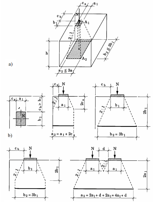

I would agree with all that said before and after, but this check related to the situation like on the picture below
But my case is little different. Imagine a concrete cube and you stend on a tip of it's edge. Will the tip crack?
