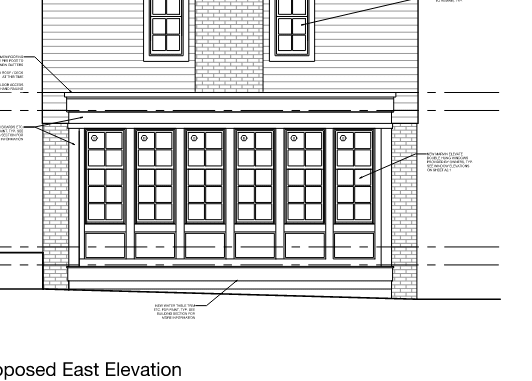

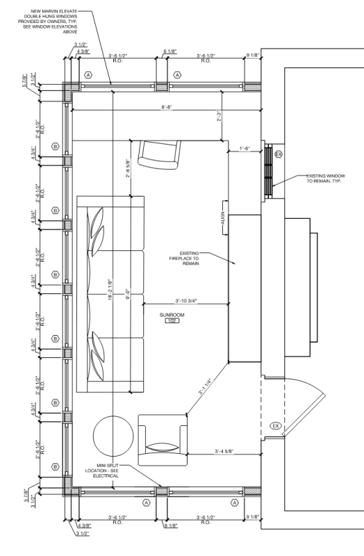

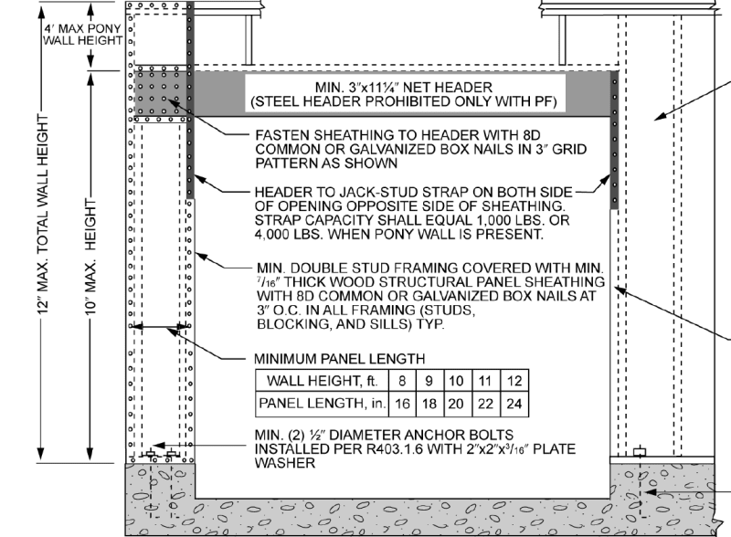

I'm designed a small three seasons room addition to a house and had a question regarding shear walls. The addition is 20'x9'x9'(H), see attached files. There are windows around the perimeter of the room. At first I was thinking of running headers below and over the windows(between the posts, so having posts go from foundation to underside of roof, so there would be a double 2x at top of the wall as well) and using a Simpson corner post cap to provide rigidity at the corners. If it's a rigid structure I was thinking it would want to rotate like a couple (see last image attached). For wind load of 20psf this is a T=C=(20psf*9'*4.5'(H))/20'=40 lbs. Does this seem like a reasonable approach? for a 40 pound load, some lags or anchors between the addition and existing structure will be adequate.

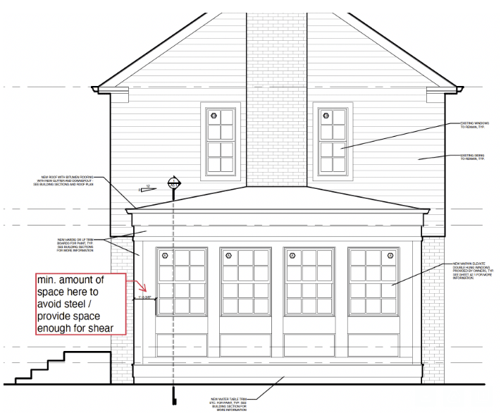

The other option is to provide a shear wall or steel frame at the 20' long wall. The architect is asking what is the minimum length of wall we need at the corners for shear. Right now it's approximately 1'-5" from corner to window. I have not run any numbers but there are many windows. From a practical standpoint, there is a similar three seasons room there now with all windows with no evidence of movement.
Just trying to figure out the best most economical way to approach this.
Thanks,

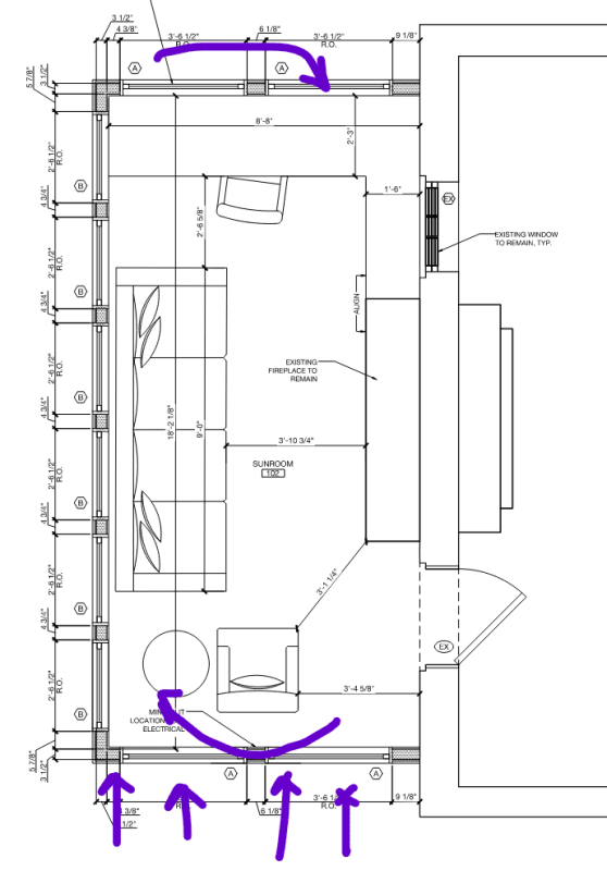

You can get vertical support from some posts, but the lateral system isn't there. If you can get the roof to work as a (rigid) diaphragm and tie into the existing structure enough, that's maybe workable. This is a cantilever diaphragm in that scenario. Think of it more like a glorified deck that's got sails between the posts (the windows catching the wind).
For wind up/down, you'd get a moment due to the centroid of the wind load versus the "one wall" of resistance (that 20' wall shared with the existing structure, [do you really have 20' of wall there with a fireplace going through it?]), and a couple due to the eccentricity of the wind load versus the up/down shear wall (ten feet, roughly), that couple has to be resolved with connections into the existing building at the upper/lower walls which go into a floor system in the existing house.
So the best approach here is to just have a steel moment frame and have the joists sit on that and everything tied together at the top. I didn't check the shear walls yet, but 1'5" long x 9' high sheathed walls likely aren't adequate even though lateral loading is relatively small.

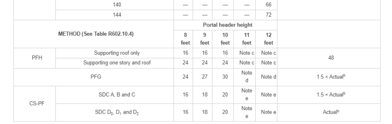

I would look at portal framing per the IRC.
You need a 16" minimum panel for an 8 ft. wall (18" for a 9 ft. wall)
If it wasn't for that big ass chimney, I'd be tempted to just use the roof connection to the house to provide the lateral stability.
My first pass with these types of situations is to do as lexpatrie indicates, treating the roof diaphragm as a rigid cantilever providing tension ties back into the floor system. Sometimes that gets tricky with any steps between roof to floor, but it looks like you got a good opportunity to tie into the second floor here. My guess is that all shear could be transferred at either side of the chimney. These solutions feel much more reasonable when the numbers work than proposing steel moment frames.
I'm looking at Table R602.10.5 of 2018 IRC and see the portal header height is 18" for a 9' wall height, for a continuously sheathed portal frame. Idk if I'm interpreting this table correctly but where is it showing the minimum panel length?
The header height is distance to the top of the header. 18" is the panel width (as was stated in my previous post)
Our table (NC) does not look like that.

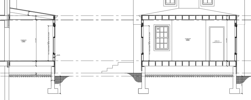

In this case, it's a four seasons room sorry. There is an existing three seasons room replacing with four seasons room and they want to potentially add a second story addition at some point. i forgot to mention that, thanks for reminding me.
As others have already said, I would try to design it will the roof diaphragm taking all the wind load. You'll need to ensure that the diaphragm can transfer shear into the exterior wall of the house and also that the compression and tension (hold-down) couple perpendicular to the wall is resisted. Due to the geometry of the addition, I think you should have no trouble making this work. The loads are small, as you already know.
For shear resistance at the outside wall, I have occasionally used columns which would go from foundation to top of window, with there being a beam below the windows tying them together laterally. So the column essentially cantilevers for the height of the window. I wouldn't do that here, though. The roof diaphragm approach is better IMO.

If they want to add a second floor, use shear walls. Whether it's a wood portal frame (look up portal frame for engineered applications from APA) or simpson strong walls.
Don't forget to check the uplift on the corners. The IRC requires these minimum width sections of walls at corners for not only lateral stability but also for an empirical uplift capacity.
Lots of wind pressure pulling up at the corners. May need strapping to resist that.

When you say get it to work as a rigid diaphragm, what exactly are you referring to? I'm imagining a shear wall on it's side.
1. Resolve all required shear into the diaphragm.
2. Design the chords for the diaphragm. Essentially the headers will be acting as compression/tension collectors, delivering all loads to the existing building.
3. What checks have to be done in regarding to diaphragm flexibility?
4. Is a sub diaphragm needed to introduce the windward/leeward loads from the wall into said rigid diaphragm?

Flotsam - how much retrofitting do you end up doing to the existing structure? Adding a single floor can often be justified globally with minor, localized retrofitting...but adding two floors? I'd start to get concerned about more of the load path. I like to make these self supporting whenever possible, and only use the cantilevered diaphragm as a last resort. People usually get surprised when you start calling out interior reinforcement for an addition they thought would be outside the existing building footprint.
phamEng - it definitely depends on the project. I'm only going to do the cantilever diaphragm if the client accepts the details required to do so, including removing interior finishes and creating the collectors into the transfer diaphragm - perhaps reinforcing existing shear walls and adding hold-downs as well. For the two-story ones I've done there was also substantial renovations in the main house, so adding those details was no problem and much preferred over a moment frame which is often the only other option when dealing with situations like the OP's where there's not even enough room for a strong-wall. I've pondered doing the cantilever column idea Eng16080 mentioned but haven't had to go down that road yet.
