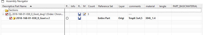

Sheet metal material in assembly navigator colum?

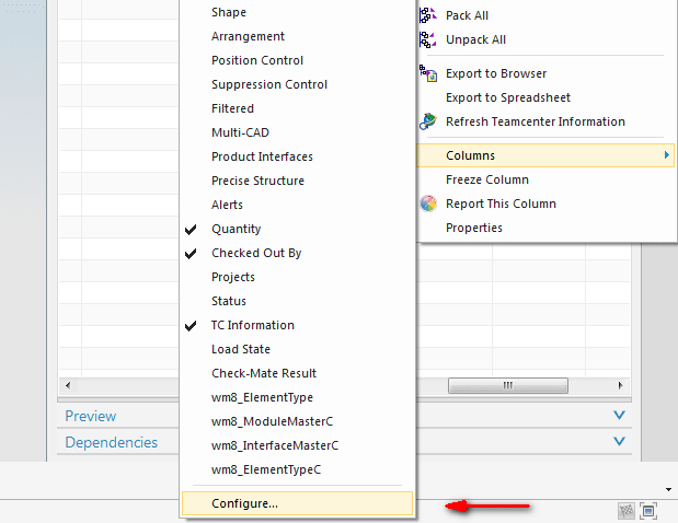

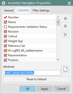

Your sheet metal part should have an attribute called PART_BASICMATERIAL or someting like that. This attribute you can add as a column to your ANT using the configure option.

Still no joy.. [sad]

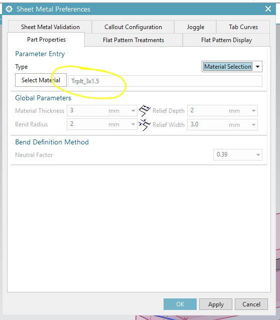

In your Sheetmetal part. Which Attribute has the value "Trplt_3x1.5"? That attribute you need to use for the column in your ANT

The sheet metal material data is not written directly to an attribute however you can add a column in the material file to do this (from NX12).
Edit your material standards file and add a column that has the attribute name for example:
Material_Name, other columns, MATERIAL_ATTR
show, other columns, attribute
Trplt_3x1.5, other columns, Trplt_3x1.5
Then you can use that attribute.
