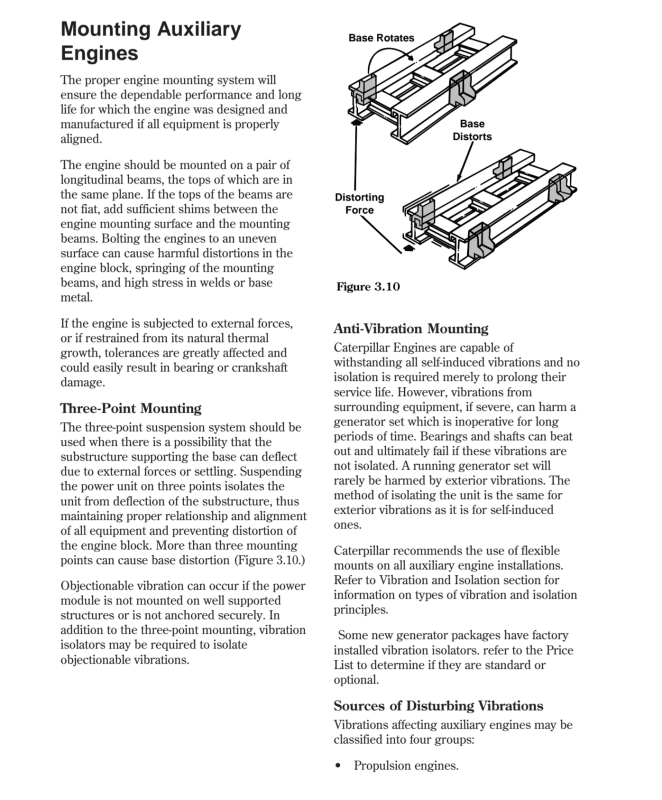

Maybe you are looking in the wrong direction. You may not want your equipment foundation to become a structural component of the hull.
Can you isolate your foundation from the hull via resilient mounting?
I have seen sliding joints utilized in structures above the main deck so that they do not contribute to the structure of the hull.
Caterpillar recommends a 3-point mounting solution so that hull deflections do not affect machinery alignment.
