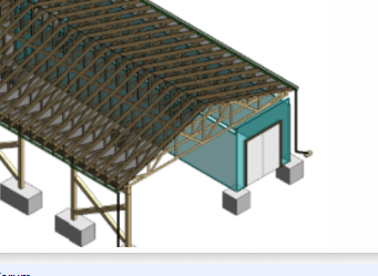

But a 40 foot container with only one door and one window?? Really?
Seems to be talking about a timber framed shed to me....
Look / read closer and you'll see that it's a timber framed shed built using shipping containers as part of the structure. I don't know what else to tell you. This is my only thread on shipping containers.
