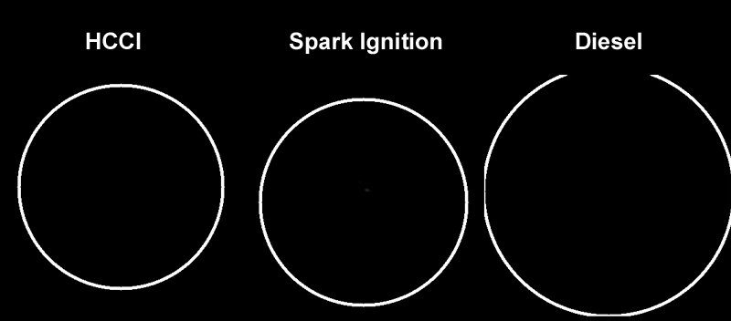

Note HCCI combustion is essentially an explosion that produces a very high pressure spike. Some designers try to spread the pressure spike in time using stratification and/or EGR. I don't; I simply use pistons of small enough bore to limited mechanical loads below the yield pressure of the steel I use for pistons, rings, cams, bearings, etc. The speed of HCCI combustion is nicely illustrated by the video I snagged from Sandia Labs.

Detonation (as the forced by HCCI) creates very high gas pressure per square inch of surface area, but reducing the piston surface area (diameter) allows tailoring of the mechanical loads to within the yield strength of the materials used to transmit power through the engine. Given the loads are thus tamed, detonation yields the highest possible pressure and temperature resulting in improved efficiency. From the many published papers on the topic, HCCI is ~5% more efficient as a result of its near instantaneous combustion.

HCCI still not explosive it is very similar to diesel, and not as bad as gasoline engine detonation with the associated shock, the ratio of the fuel charge is a controlling factor too.
Take another look at the video showing HCCI, spark, and diesel combustion. Diesel combustion occurs at the leading edge of the fuel spray and has the longest duration of the three. HCCI ignition and detonation in a spark ignition engine are similar but differ in a couple of ways: First and foremost, explosive combustion in a spark ignition engine is an unplanned event occurring before TDC in a spark ignition engine and produces stress outside design limits while explosive combustion in an HCCI engine is planned and produces stress inside design limits. Furthermore, detonation in a spark engine is caused by a hot spot, excessive compression, or a combination of the two while in HCCI it is solely the result of compression. When detonation is caused by a hot spot, combustion occurs at a speed similar to that seen when a spark ignites the fuel; a flame front is developed which takes time to spread through the air/fuel charge. When detonation of a premixed air/fuel charge is caused by compression, the chemical reaction is theoretically simultaneous throughout the charge. In an actual engine, the air/fuel charge is not perfectly uniform, however, so ignition starts in one or more regions then spreads rapidly to the other regions due to the pressure waves that spread through the intake charge increasing charge temperature.
Gasoline engine detonation has other causes as well and can happen at a moderate CR.
