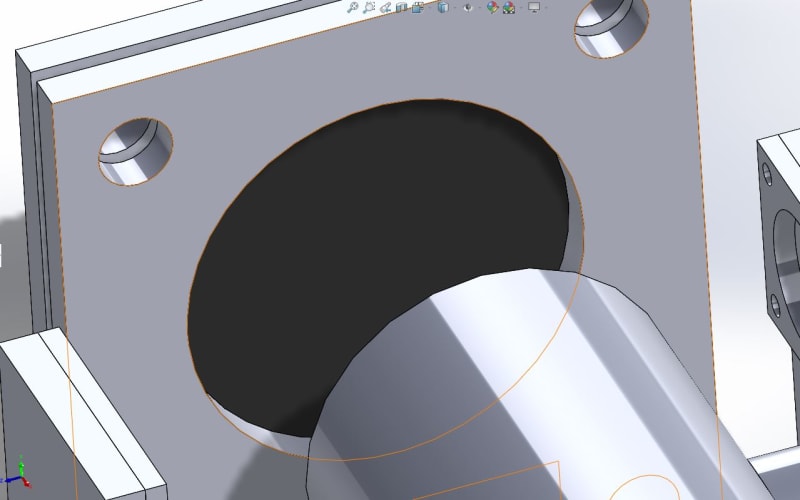

Thank you for the information! My plan is to use a rubber sheet with a steel backing plate and then held in place by sandwiching it with another plate with a hole in the middle like this:
so the rubber will be fully supported.

For your test apparatus, I would suggest bonding a rubber disk to the backing plate (inside the hole). This will give more support for the rubber without altering your design. Compressing the rubber between two plates will bulge the portion in the hole making it difficult to seal against.
