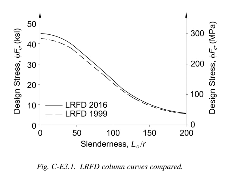

Does anyone have any information on when (what KL/r) you could realistically expect a short column to yield in compression instead of buckle. In the AISC 360-16 code as KL/r goes to zero, Fe will go to infinity, and the Fcr term will go to Fy. Obviously you could solve for the Euler buckling length that would result in a critical buckling stress of Fy, but if you plugged that length into the AISC code then you would get <Fy (you will only get Fcr = Fy when KL/r goes to zero). I am assuming also the column's elements are compact so no local buckling will occur. Any information is appreciated. Thanks

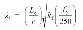

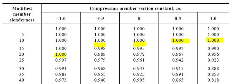

In the Australian codes, the modified slenderness factor (below) has to be less than about 15-25 for there to be no reduction in capacity due to slenderness/buckling. This also includes the material strength.
The exact ratio depends on another factor alpha_b, which accounts for things like residual stresses from welding or hot rolling, and possibly geometric tolerances.

My understanding is that the buckling formulas incorporate an additional factor of safety to account for imperfections / accidental eccentricities. That'd be why you're not getting your full 50 ksi with the formulas. Imperfections wouldn't have much of an effect at short lengths. Eccentricities however definitely would - the column sitting on the baseplate at short length would behave much more like a fixed connection than a pinned connection.
