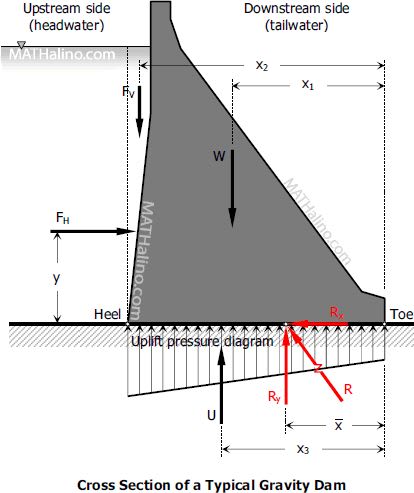

This approach is OK as long as the water levels are high ( HWL) at both sides.. In case of rapid draw down , soil side WL could be still high ( depending on the soil type and drainage cond) . The uplift force developing under the ftg will be triangular and could trigger the rotational failure together with horizontal hydrostatic load.

- No... not really.. if the WL at both sides are the same, and the soil is permeable, the uplift will develop but will be uniform..In this case when you subtract the unit wt of water from submerged wt of soil and concrete ( literally working with effective stresses ) the uplift is accounted ..
If the water level is high on one side, but nonexistent on the other side, and if the soil is permeable so leaking.. a triangular uplift will develop under the footing. In this case, you SHALL work with total stress analysis.You can not consider the concrete as "submerged".
In this case, for OT check ;
- Stabilizing forces = wt of concrete T wall+ submerged wt of soil above heel cantilever.
- Destabilizing forces = active force of soil+ hor. hydrostatic load of water + triangular uplift forces under the ftg.
The following picture is useful to get the concept. Notice that , (Fv + W )are stabilizing forces while (Fh and U ) are destabilizing forces..
