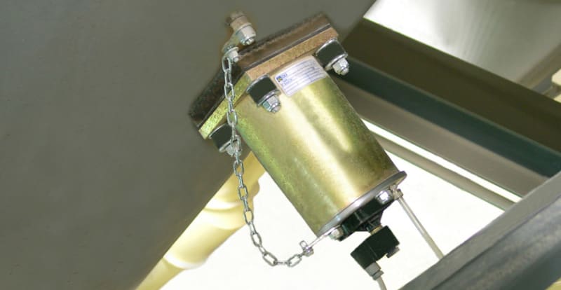

If you have aggressive hopper activators then fatigue can very much be an issue. Vibrators can lead to local fatigue cracking. Pneumatic hammers I've seen destroy hoppers in a matter of months. (The is a reason why the damn things have safety cables. It seems not a matter of IF they will fail but WHEN!
