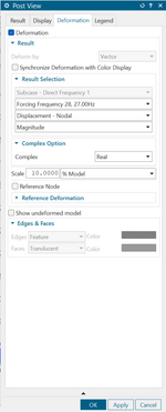

Hi all!
I am running a direct frequency response analysis, and was using a test cantilevered beam to make sure my setup was correct. I performed a frequency sweep, but when I visualized the results, it shows the beam bent up instead of down, even though the force is acting downward. Can someone why Simcenter is visualizing the issue in this way? Can you just not trust the visual results of a direct frequency response solution and instead look at a static response to visualize part deflection?
Pictures below

In Frequency Analysis you define oscillating load that change from positive to negative value according to sine function. In result of Frequency analysis you obtain Amplitude and Phase of some value of interest (like stress, force of nodal displacement). Amplitudes have only positive values but it is suggested that all you result values also change from positive to negative values according to sine function.

In Femap you can use tool Model->Output->Process to multiply all results by "-1" but i don`t know if NX has similar tool. Again in Femap it is possible to expand dynamic results from Amplitude/Phase to results at discrete phase angles so you get results from positive to negative amplitude with some step like 10 degrees so you can find case with negative deflection.

thanks for the info! I ended up finding a setting in the "Edit Post View" under the Deformation Tab. Changing the Complex display option from "Amplitude" to "Real" displays the correct deformation in the graphics post viewer.
