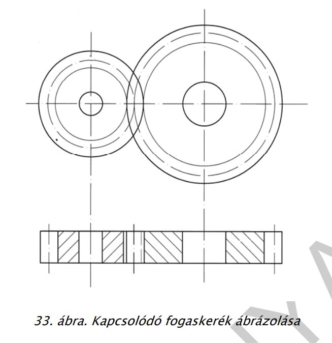

Hello,
Is there a standard on how to show simplified representation of gears and chains? I see no added value to represent each tooth or each link of a chain. I can't seem to find the information on the books I have on hand.

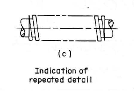

I don't know of a standard. I've seen various. Pitch line and pitch diameter for representing the drive ratio. A representation of the inner and outer chain path and the OD of the sprockets for clearance drawings, sometimes with a limited arc of the gear showing the chain so the pitch is visible.
3DDave
With a thin phantom line?
I'd lean to a thicker line width, but phantom? I guess. It will need to be labeled.
For simple representation, only the first tooth and the nearby half tooths may be shown, then complete with the OD circle. The pitch circle and pitch line is thin dash-line type (or dash-dot on older dwgs).
Also the teeth can be omitted completely.
OD is thick, p.c.d. is thin just as tooth bottom dia.

Per ASME Y14.2-1992 Line Conventions and Lettering
Fig.12 PHANTOM LINE APPLICATIONS
