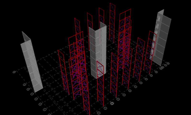

I have reviewed related posts but am still unsatisfied. [URL unfurl="true"]https://www.eng-tips.com/viewthread.cfm?qid=399108[/url]
So...what effective length are people using for single angle X-braced frames in R=3 SDC A/B buildings? They are braced at their intersection with a single bolt in an OVS hole. I am not a fan of using these single angles but apparently that is the standard for self-storage buildings. And, the prototype building I am trying to base my design on appears to have used the recommendations from this report ( which recommends an unbraced length of 1/2 the total length and K = 0.85. These recommendations don't seem to mesh with anything else I can find and seem to fly in the face of AISC Table 4-12, eccentrically located single angles, as well as AISC chapter E.5.
I would love to just make these tension-only, but my drift and load distributions depend on sticking with the X configuration.
-Mac

Jayrod - this is a 7-story storage building 90x170. Pretty unique around these parts.

I don't know what to tell you, except that it does, and particularly so when the braces are working in combination with masonry shafts. I do not want anymore lateral load going into my masonry at this point. I have done enough high-rise tension-only strap bearing wall systems to know how quickly the stiffness distribution of the system is affected by minor adjustments in brace areas, etc.
I understand the example building is not going to be the same, but I am not trying to re-invent the wheel too much. Our client *is* the builder and they are very particular about keeping things similar, or at least the design logic similar to previous jobs. They also want optimization of steel weights. I am working with the hand that has been dealt to me, in many respects. There isn't enough time in the day to explain the quirks of this client, but they pay our bills and keep coming back.
I am leaning towards just using the eccentric angle tables in the manual with an unbraced length of 1/2 the total length...in lieu of trying to manipulate KL in RAM since RAM assumes concentrically loaded braces. This approach feels reasonable as it accounts for the tension member bracing but also reduces the angle capacity based on the eccentric gusset connection.

I certainly would rather not. For DD plans, I am running with an arbitrary KL of 1.0 times the full length of the angles with phiPn being from AISC Table 4-12, eccentrically located single angle. Conservative for now and I may or may not refine later.
-Mac
