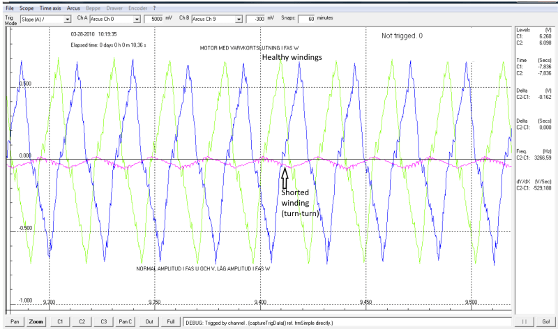

An easy way to verify a turn/turn short is to look at stator voltages when you rotate the rotor.
Any scope can be used. Even a simple volt-meter.
Gunnar Englund
Most single phase motors are three-phase. Some are two-phase. The technique works just as well on a two-phase winding. Only shaded pole motors have a single phase winding. And they ere not even 1/8 HP. A few watts, mostly.

It is usually possible to connect to the windings. And you do not need to separate them.

I think I understand what you are saying, Even though the winding's are connected in series The OP can connect a scope and when the rotor passes the pole with a shorted winding the
difference will be apparent at that rotor position. Would this be a true statement Gunnar?

Gunnar's method has merit but there are issues.
The majority of North American single phase motors have the start winding displaced 90 electrical degrees from the run winding.
With most of those motors the start winding is not identical to the run winding.
You can expect the run winding to produce a different voltage than the run winding.
A shorted turn will still show a low voltage but it is a judgement call if a low voltage is an indication of a shorted turn or a normal condition.
A comparison to an identical known good motor is a good method if an identical known good motor is available.

No, Chuck
You will not have any idea where the rotor "frozen" flux is. But if the windings are in series, there is a common point where they meet. Measure from there. The one with low voltage is the one that is shorted.
Actually, it doesn't matter which one. You still need to rewind (or scrap) the motor. But if both (or all three) readings are within around 10% then you can safely assume that there's no short-circuited turns. And look for other problems.
