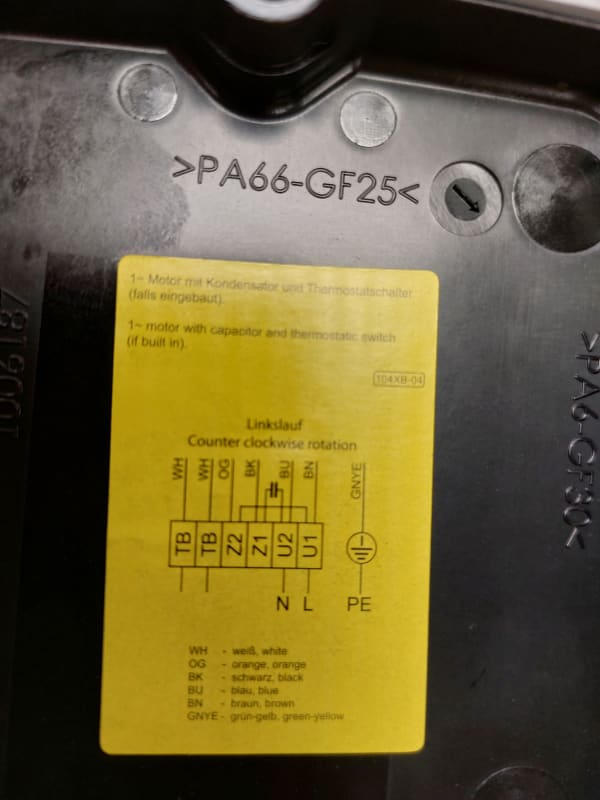

I wonder if someone can help me out?

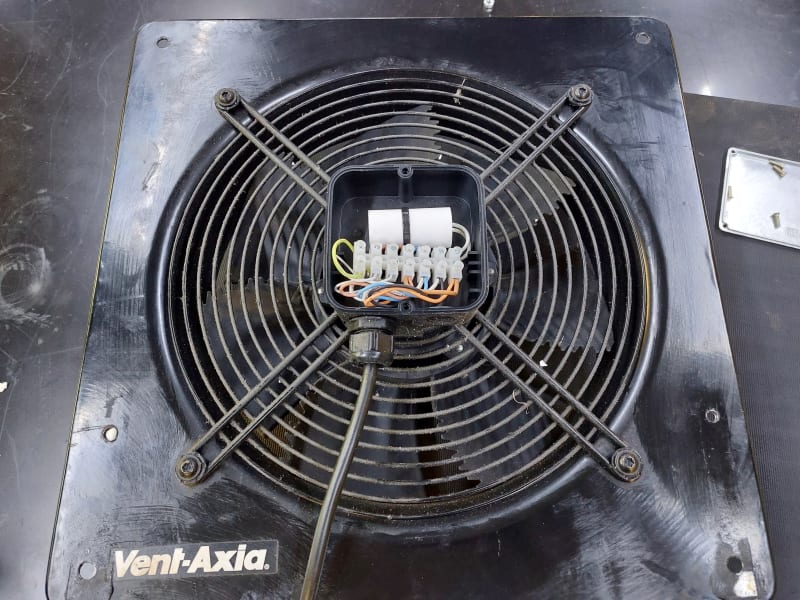

We've repurposed a single phase plate fan and it seems to be running backwards.
Could someone advise on how to change the wiring to swap rotation?
It is wired as per the diagram attached,and I don't think it's ever been altered but it's definitely running backwards - the airfoils are running "feathered edge" first and as you look at the fan it's running clockwise, contrary to the wording on the diagram.
(It's been an awkward install so just turning the fan around and running it backwards would be difficult (and would annoy me everytime I looked at it, to be honest).
I've searched the forums but it would be handy if someone with more knowledge than me could offer any assistance with this particular motor.
Many thanks!
Rob

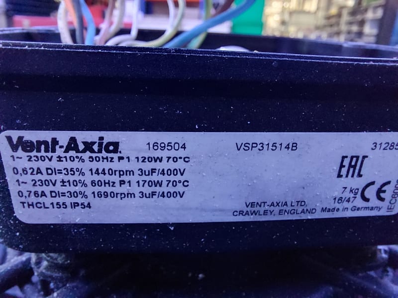

More details on the motor would be good (manufacturer / model no, power etc.
Also here's the picture for anyone else
Thanks for taking a look.
There's not a great deal of information but hopefully this will help:

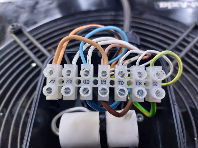

The wiring diagram and actual seem to be different.
From L to r the diagram goes white white orange black blue brown
The actual wiring seems to go white white orange blue black brown.
So maybe swap the blue and black wires and stand back....

Dear Mr. RobWard (Industrial)(OP)
I would like to submit the following for your consideration:
1. Principle, to reverse the rotation; you may either (reverse the current) through the [(run winding) or the (start winding)]
i.e. (a) transposing the orange and black leads = reversing the start winding.
Or (b) transposing the brown and blue leads = reversing the run winding.
2. Do NOT "...just pull the blade assembly off of the shaft and flip it ..."
Che Kuan Yau (Singapore)
Many thanks for the replies.
Firstly, apologies to all - I should have made clear that the terminal block is labelled and that the wiring is correct to the labelling, it's just that the terminal blocks are in a different order to the diagram.
So, just for future reference, whilst a 3 phase induction motor would have its windings wired Un- Wn, on single phase motors is it usual to label the start windings "Z"?
I'll reverse the start winding, as suggested by Che Kuan Yau, and see what happens.
It's a good job I didn't swap the orange and blue leads as I'd suggested!
Thank you all so much for taking the time to help.
Rob

Well I can report that we have a success!
Thank you all for your help - you have saved me an awful lot of work and I'm gladdened to see the fan running correctly now.
