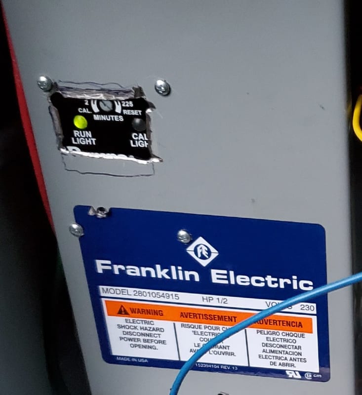

I had to hack the damn thing because the plug-on PumpSaver was a nightmare.
Because of the screwy design the capacitor and the relay are mounted on the back of the face cover of the NEMA 12R box. The PumpSaver requires you look at its live face to adjust it. Look where they placed the face! So I had them open a hole in the box since it was inside another enclosure anyway. Beautiful work they did. LOL.
Pulling the entrails out of the box will fix the PumpSaver problem too.

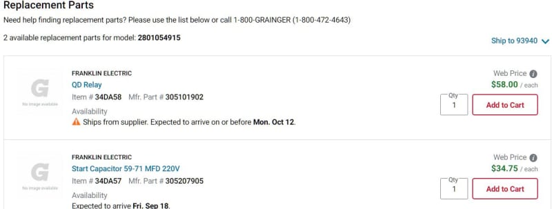

The Franklin is $61 at Grainger.
You can buy the replacement parts: Cap and QD relay there for only...
$93.
Typical. The box it is.
