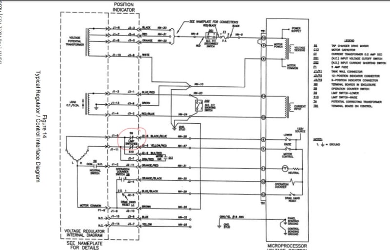

Hello,
Does anyone know what may cause a voltage regulator to get stuck on step -/+16. We have regulators that will occasionally get stuck on 16. We try to place them in Manual and raise or lower them but they won’t budge. They seem to just get stuck on the limiter switch. I don’t understand why it locks out on 16. We end up having to open up the position indicator glass and moving the hands this way.

Just the indicator hands get stuck? If you are wiggling the hands and the regulator starts stepping it’s an electrical problem that could be fixed by restricting the steps.
Some VR's have the dial indicator on a chain drive that connects to the switching mechanism. I found one a while back that was not properly sync'd, so it was one tap off and causing circulating currents. I imagine if this was the same type, moving the dial may affect a limit switch. Other manufactures have a flexible shaft that drives the position indicator.
VR's & LTC's have a limit switch that kills the motor and prevents damage if the control looses it's mind. If the limit switches are not adjusted properly, that could be the problem. As shown below, the limit switches are normally closed and open when past the limit.

What model? Moving just the hands by opening the glass would not fix the actual tap position.
I have had the software loose track of the tap position, which then makes the software think the limits are in the wrong spot.
I have seen where the breaking solenoid had a problem, and it would miss a tap. In doing so it would continue, as it does not want to be off tap.
