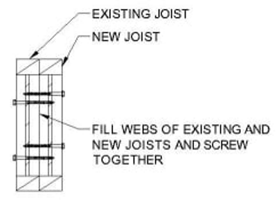

Hi everyone, I've got a situation here with a proposed fix that I'm curious if anyone has some input on. I have posted a picture below of the second floor framing plan for a home that is going to be remodeled. The two bubbled walls are to be removed to open up the kitchen. When I was at the home I discovered that the joists over one of the walls break rather than running continuous over the wall (shown below). However, the joists over the beam and the other wall run continuous without breaking. The obvious solution would be to put in a big steel beam that spans across the new open kitchen, but doing so is not feasible on this project.
My question is what if we sister some new, full-length joists to the existing joists instead of putting in a beam? The span from the back of the home to the garage wall is only about 17'-6" which is easily doable for an 11 7/8" joist. I'm not sure why they didn't do that in the first place, but here we are. Has anyone done this before? Any suggestions or concerns?

This solution would be amazing, but it also makes me queasy just thinking about it. The new joist would be transferring the bending and shear load back into the two separate existing joists and I'm not sure how that kind of connection could even be calculated. Sistering to an existing full length joist that has a notch or crack or something makes sense to me, but in this case where the existing joists fully break over the wall with a 1.5" gap between the ends...I don't see how anything but a new full-length joist that bears on the wall at each end would be acceptable. I'm open to to your idea because it would be awesome if I could get it to work, but I don't think I understand it well enough to be comfortable with it.

For the longest time I was anti-sistering (reinforcing existing joists with new ones that don't bear on the supports) because I wasn't confident how the load gets into and out of the sistered joist. Recently, I modeled such a condition in RISA 3D. I attached the joist with common nodes at 12". It worked beautifully.
If you are able to run full length joists and get bearing at each end, that would be great. I would fasten the new joist to the existing joist because I'm assuming you cannot attach the new joist to the floor sheathing. This way, you are using the existing (broken or cut) joist only to transfer the load from the sheathing to the new joist.

Sistering another beam to the existing "joists" will be difficult... be cause the "joists" are actually I-Joists. The OP's detail shows the connection through the 3/8"+ OSB web... I would not rely on that for significant loads:
Instead, I would check to see if adding plywood plates to the sides of the existing I-Joists (creating a box beam) would be an adequate splice and bridge the 1 1/2" gap between the ends of the I-Joists. My preliminary calcs indicate this will work... if tributary area for each I-Joist is "small" (which it probably is).

I feel like nailing into the edge of the I-joist flange is sketchy at best. I do not like i-joists for many reasons but this is the main one - they suck for remodels. I would do a full length one next to the existing as JS mentioned. If it is a 2x4 wall, you could cut it 3 1/2" short and still get 1 3/4" bearing at each end - which should be sufficient.

A couple important things missing from this discussion:
1) What is the foundation under the wall you're proposing to turn into a bearing wall. Granted, it's probably got some load on it now, but you'll be increasing the load on it by quite a lot. Looks like you're putting at least 845plf into that wall - it'll need something beneath it.
2) What is the uplift capacity of any connectors to the "Existing Beam in Garage"? Pull the current supports out, bending moment in the joists will increase as the span increases and the second span will be less than a quarter of the main span. The uplift force could be enough to damage the connection to that beam. I estimate about 450lbs of uplift for full live load on the long span.
What size 11.875" I-Joists are these? Yes, some heavy ones can manage these spans, but not all of them. You're flirting with the line between a floor that meets the minimum building code and a floor that is comfortable to walk on. With long spans, a code minimum floor is a nuisance with lots of vibrations - even if you can't feel it, you'll hear stuff rattling as you walk. After all, you can't guarantee that the existing floor is glued down, and if that's a big and wide open space it'll vibrate like crazy. If there are bearing walls, it gets harder to make the joists work for strength.
If we're not doing a beam, I'm in the LVL camp. Fill one side of each of the existing joist webs with OSB/plywood of appropriate thickness. Get LVLs in there - you might be able to do a 'fire cut' at one end to allow them to insert it onto the bearing wall and then rotate it up and into place to fasten to the beam in garage. Of course, shoring while doing that will be interesting. They may need to remove finishes from the exterior and insert them from outside.
