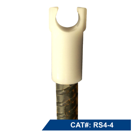

These provide isolation for your situation. No idea on availability.
[URL unfurl="true"]https://deslinc.com/rebar-saddle[/url]
