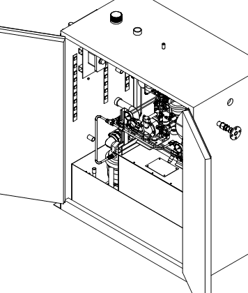

A drawing always helps.
It's actually a Lift Station with double containment, see image.
Thanks for your responses! I did think the volume includes the tank itself. But because it's not spelled out anywhere and our AHJ can be pesky at times, I figured I'd ask.
I design aqueducts in a parallel universe.
Ah, that makes more sense.
By the look of it though any leak from any of that pipework will spray out over the containment tank.
And any volume of equipment in the containment bund needs to be removed from the volume available.
